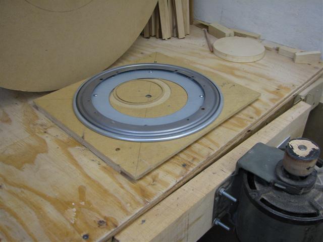

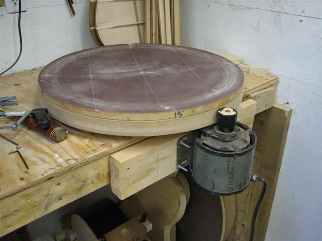

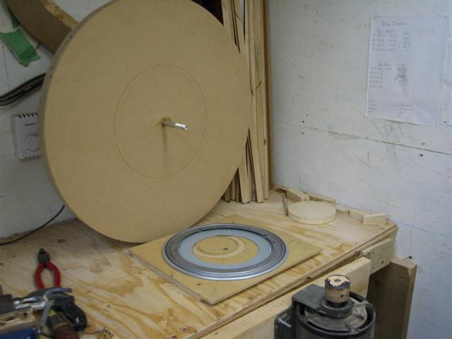

[quote=Billy T]Rod: Thanks for the link to the motor disk sander. That wouldn't have to be dedicated desk space would it? [/quote]
Hey Billy it deffinatly doesn't require dedicated space.
Following Mike's little tutorial, this is a pretty easy jig to build, and modify the motor mounting as well. I made my drive pully out of maple, than I used plati-dip for the grip coating but it didn't work so well. I think I will put a strip of 80 grit on it instead, that should work fine.
But it did work very well, sanded the rim really easily and quick.
Here are a couple of quick pics I took yesterday.
And the back after sanding, ready for linings.

   Thanks for the pix Rod! The only thing I would be troubled by is getting....something.... caught in between the drive wheel and the plate! Yeowwzzy!!
[quote=As Hesh]Gotta protect your .........never mind....... [/quote]
    "Dedicated space" is eliminated by the center bolt! Cool!
